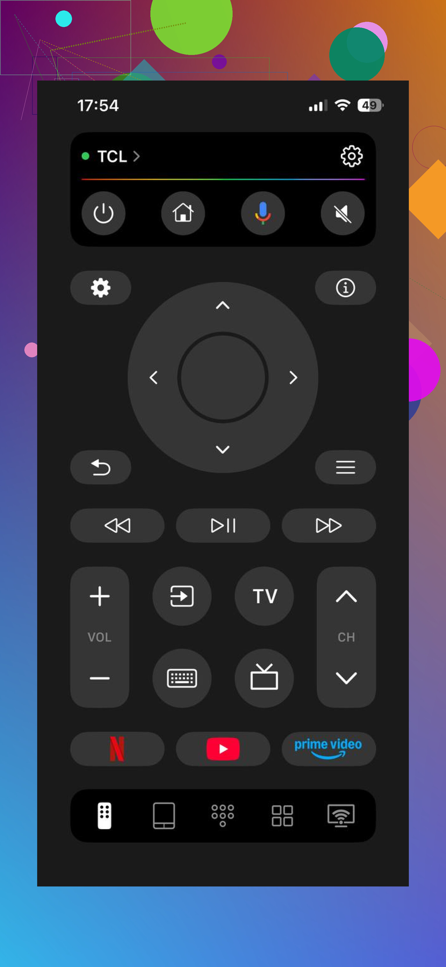

One useful test is trying a different remote app. If the official app is being flaky, something like TVRem can help narrow it down. It supports Samsung, LG, Roku, Fire TV, Android/Google TV, and Apple TV. If one app connects and the other doesn’t, your network is probably fine and the issue is with the app itself.
