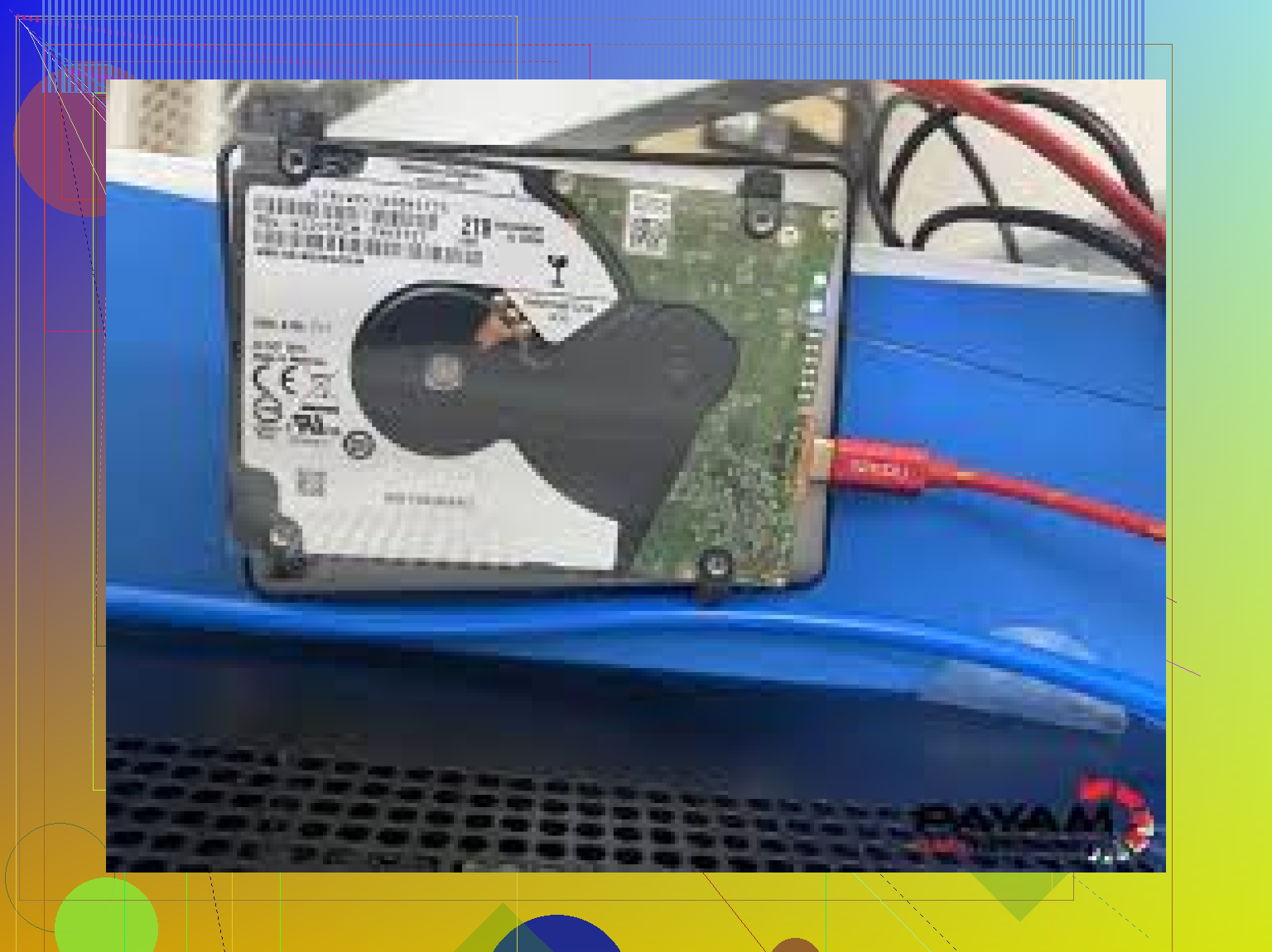

My desktop’s hard drive just started making a loud clicking noise and now Windows won’t boot. This drive has years of personal photos, work files, and documents I never backed up. I’m worried powering it on might make things worse, but I really need to save the data if possible. What are my best options to safely recover files from a clicking hard drive, and what should I avoid doing so I don’t cause permanent damage?
So my WD Elements 1 TB drive started clicking about three days ago and I did what most people do the first time. I freaked out, unplugged it, plugged it back in, waited for Windows, nothing, repeated that cycle way too many times. Took me way longer than I want to admit before I stopped forcing it.
Here is the part I wish someone had hit me over the head with on day one: that repeating click from a hard drive is almost never a “software glitch”. It is usually the drive trying and failing to read itself. Most of the time it is either:
  • Heads are damaged or unable to calibrate.
  • Platters are struggling to spin up properly or the drive keeps resetting.
Once it starts doing that, no recovery program fixes it, because the drive is not reading data correctly in the first place.
What I learned the hard way
The first useful thing I did was stop powering it on at all. Every extra power cycle on a drive that clicks increases the odds of:
  • Heads scraping the platter.
  • Heads slamming back to the parking ramp again and again.
  • Media damage that turns “difficult recovery” into “no recovery”.
Once platters get scratched, your data is usually gone in those areas. No software overcomes physical damage.
So if your drive is clicking right now and you are still experimenting with cables and ports, stop. Leave it.

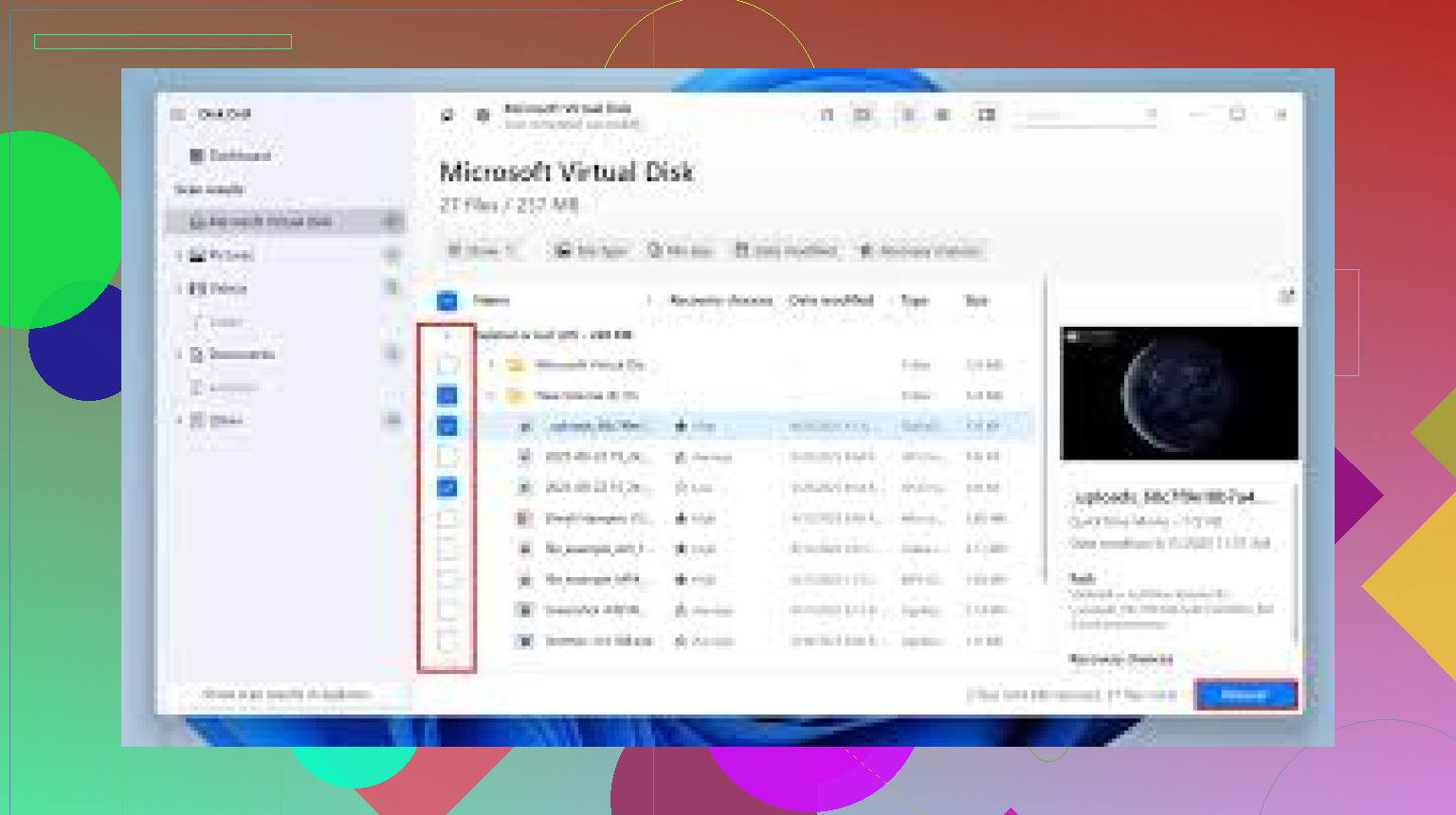

  1. Forget “repair”, aim for imaging
    Do not run file recovery tools directly on the bad drive. You want a raw clone first.
Use an imaging tool that supports unstable drives and sector by sector cloning, with options to skip bad blocks and retry lightly instead of hammering them.
Disk Drill is an option on a separate healthy machine if the drive still mounts at all. You would attach the failing disk as a secondary drive, then tell Disk Drill to create a disk image. Work only on the image after that. Do not let any tool “fix” the original disk or write to it.
If the drive clicks hard, stalls the system, or drops out during imaging, stop. Every extra minute spinning in that state risks the heads scraping the platter.

  1. Physical vs logical: your drive almost certainly has a physical issue
    Given:
  • Loud, repetitive clicking
  • System drive, won’t boot
    That’s almost never a simple filesystem error. chkdsk, “scan and fix,” or any “repair my disk” wizard is the last thing you want. Those all try to write to a drive that is already misreading sectors.
If BIOS does not see the correct model and full capacity anymore, software recovery tools will not resurrect it. At that point, only a lab with clean-room, donor parts, and hardware imagers has a real shot.

In that case, your only DIY move should be imaging, not “recovery” directly:
  • Use something that can deal with unstable disks and create a sector-by-sector image.
  • Do not browse the drive in Explorer, do not open photos directly from it. That makes the heads jump all over the platters.
Disk Drill is actually decent here:
  • Run it from your healthy system disk.
  • Tell it to create a full disk image of the failing drive onto another good drive of equal or larger size.
  • Work only on that image afterward, never again on the original drive.

3. Where Disk Drill fits in, realistically
Everyone has said “make an image.” The practical issue is which tool does not absolutely punish a weak drive.
Disk Drill pros:
  • Nice at working from images; once you have a clone, it is very user friendly.
  • Can create a byte‑for‑byte image in a straightforward way, so you are not poking the failing drive through Explorer.
  • Good at rebuilding file trees and previewing photos from that image later.
Disk Drill cons:
  • It is still software that talks through the OS stack. On drives that lock up the bus, you will get freezes and disconnects. It does not replace hardware imagers that labs use.
  • Default settings are not always gentle. You have to configure it to image first and avoid “quick scan” that jumps around the disk.
  • On heavily degraded media, it can hang rather than degrade nicely, so you need to be ready to pull power if the system becomes unresponsive.
Compare that with the vibe from @voyageurdubois and @mike34: they are thinking more in terms of lab‑grade hardware imaging and strict “no touch” if you really care. @mikeappsreviewer did a good job spelling out heads / platters / lab costs but, like most of us, comes from the perspective that physical damage is not a software problem.
So if your drive is still detected, spins fully, and you have accepted the risk:
  • Use Disk Drill’s disk image feature to target the failing drive.
  • Save that image to a totally separate healthy disk.
  • Keep reads linear, avoid scanning the full file system tree directly from the failing disk.
If Disk Drill chokes very early or the drive drops, do not start trying three more imaging tools. At that point, continued attempts are just lab‑chance erosion.
