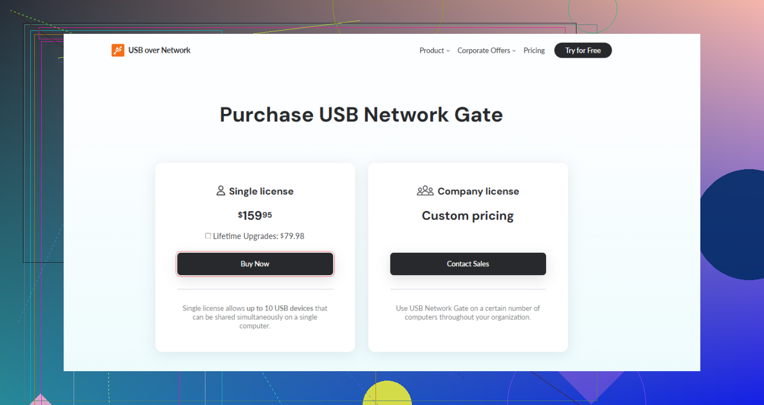

For folks juggling more than a couple of gizmos remotely, USB Network Gate is actually the budget pick. First, it is free for personal use and lets you work with 1 USB device. Here’s the wild part: you’ll fork out $160 to connect up to 10 toys, which is a solid deal as far as this niche tech goes.

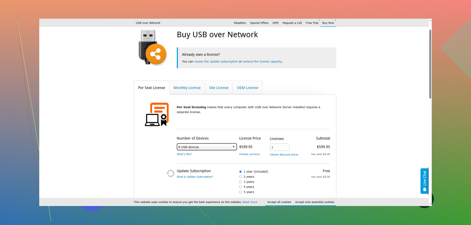

Now, let’s talk about the other popular choice—USB over Network. Want to link up to 8 things? That’ll set you back almost $600. Ouch.
