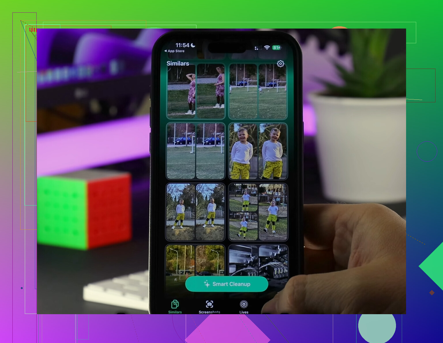

On mine, the mess was years of junk. Screenshots I never deleted. Duplicate photos. A few giant video files sitting there like bricks. I tried sorting it by hand and gave up fast. What worked for me was Clever Cleaner. I used it to spot the biggest files first, then clear out duplicate and near-duplicate images without digging through the Photos app forever.
A couple things I liked. It was free when I used it. No ads popping up, no locked features every two taps. It also handled the scan on the device, which mattered to me because I didn’t want my photo library shipped off somewhere. The 'Heavies' section made it easy to find the storage hogs, and the 'Similars' view caught blurry repeats and accidental burst leftovers. I cleared around 15GB, maybe a bit more, and the iPad stopped choking almost right away.
