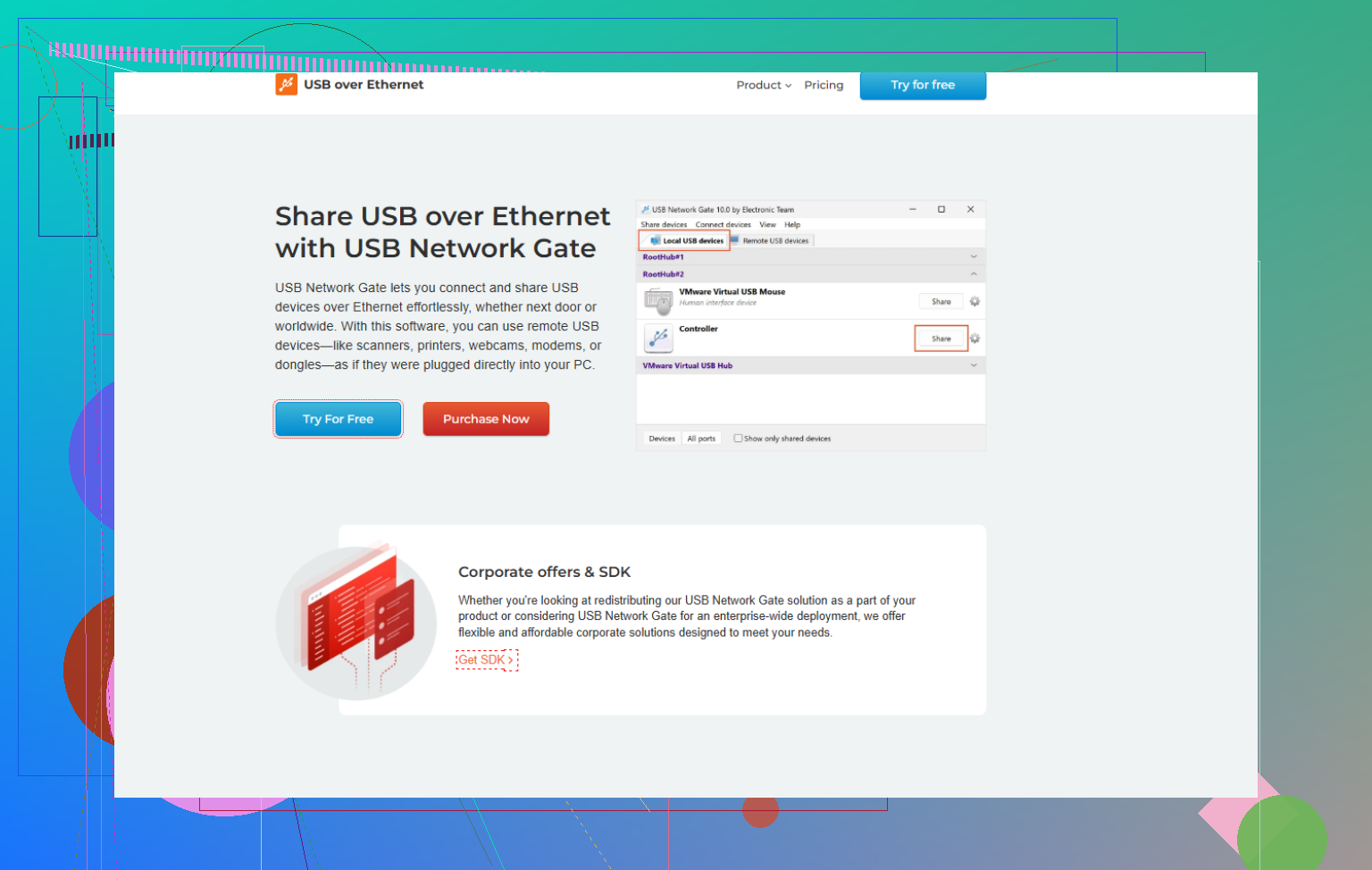

I ended up switching to USB Network Gate. It does the same “USB over network” thing, but the driver stack was a lot more stable and it handled reconnects and sessions way better on mixed Windows builds. If you want an in depth walk through on setting up a stable USB over network workflow and why I swapped tools, this article helped a ton:
how I finally stabilized remote USB sharing on Windows
That piece is basically a real world USB over Ethernet tutorial: covers how to choose the right port configuration, deal with drivers, secure the connection, and avoid the exact “shows up but won’t connect” limbo you are hitting.

7. At some point, consider switching tools
Not to pile on, but I ended up in the same situation: after a Windows update, KernelPro would randomly stop accepting sessions. No meaningful error, nothing in UI, just dead.
I finally switched to USB Network Gate. The virtual USB driver stack has been more stable for me and reconnects after network blips are way less flaky.
If you want to try that route, you can grab it here:
download USB Network Gate for reliable USB over network sharing
That solved the “client sees device but cannot establish session” problem entirely in my setup, using the exact same hardware and network.

6. When you are evaluating alternatives
Both @cazadordeestrellas and @mike34 ended up moving away from KernelPro after similar ghost session failures. If you are at the “my time is more valuable than one more registry pass” stage, trying another driver stack is reasonable.
USB Network Gate is one of the more popular replacements in this space.
  • The client/server versions are kept in sync and tend to handle mixed Windows builds better.
  • Session handling is usually more resilient to brief network drops.
  • The UI gives clearer feedback when the driver or service is not actually attaching, which helps avoid the “device shows but never connects” limbo.
  • Plays relatively nicely with VPNs and complex routing in many setups.
  • Licensing can get pricey if you need a lot of endpoints.
  • Still a kernel-level driver, so not immune to security suite friction or Windows update breakage, just less temperamental in many reports.
  • Advanced features (encryption, multi user sharing, etc.) can add complexity you might not need if you only have one dongle or one device.
If USB Network Gate connects to the same USB device and network environment on the first try, that is a very strong signal the problem really was in KernelPro’s driver / service stack rather than your hardware, firewall or cabling.
If I were in your situation now:
  1. Do a quick permission / AV check as above.
  2. Try from console sessions only, no RDP, with AV relaxed.
  3. If it still presents the device but refuses to open a session, test USB Network Gate on the same hosts.
  4. If that works consistently, call it a KernelPro issue and stop burning hours on driver archaeology.
