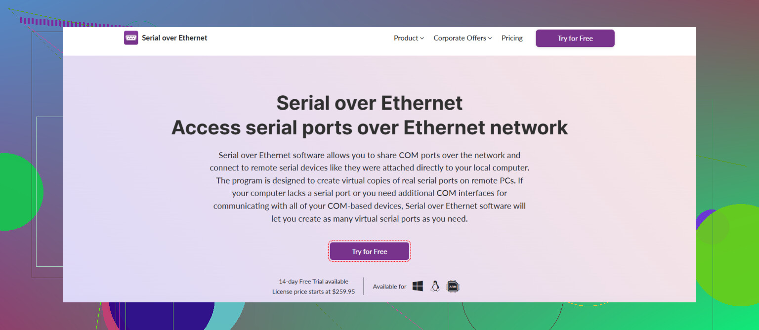

2. Software route (what you already kind of have)
You plug the USB‑to‑serial into a local machine and turn that into a “serial over network” server, then expose it as a virtual COM port on the remote machine.
This is where something like Serial to Ethernet Connector fits really well. It does:
  • Creates a virtual COM port on your remote PC that maps to the real serial port on the host
  • Supports raw TCP or secure tunnels depending on your setup
  • Lets multiple clients read from one serial device in some configs
  • Works with most apps that only know how to talk to COM1 / COM2 / etc
If you’re after a clean “remote serial port like it was physically plugged in” experience, that’s exactly what it’s for.

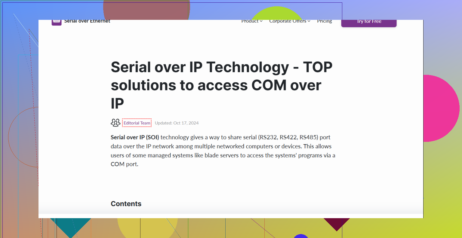

If you want to learn more about the concept in general, this page explains the idea of turning a regular serial line into a network reachable interface pretty well:
how to access serial devices from anywhere via your IP network
